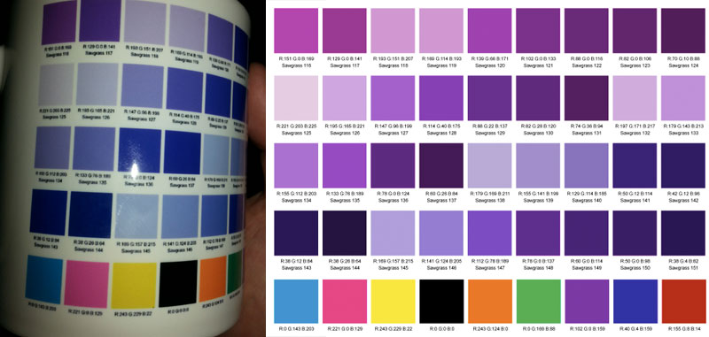

just to follow up, the difference between the swatches on screen and when printed and transferred to a mug are phenomenal! i'm beginning to think now I've something wrong with my setup. have emailed sawgrass also, to see if they can be of any help!

Re: purple printing/transferring as blue!
heres the difference...the photo of the mug is not great as its my phone camera and has washed the colours out a bit, but it shows a huge difference

For the best results at colour matching, you need a custom ICC profile - one made for your printer and inks, and also one for your monitor.
Then in Photoshop (with Photoshop in charge of colour management and not using PowerDrive), then with it in "Proof Mode" and "Gamut warning on" you will get a pretty close representation on screen of what's going to print onto your products.

Anyway, I bought a Profile from Paul and it did make a huge difference to my colours, and I do mean a huge difference.
I ended up going down the supported route though, which is infinitely more expensive than buying an ICC from the young man.
Without an ICC profile for your inks, you are effectively printing colour blindNikGrey;79047 wrote:Anyway, I bought a Profile from Paul and it did make a huge difference to my colours, and I do mean a huge difference.
