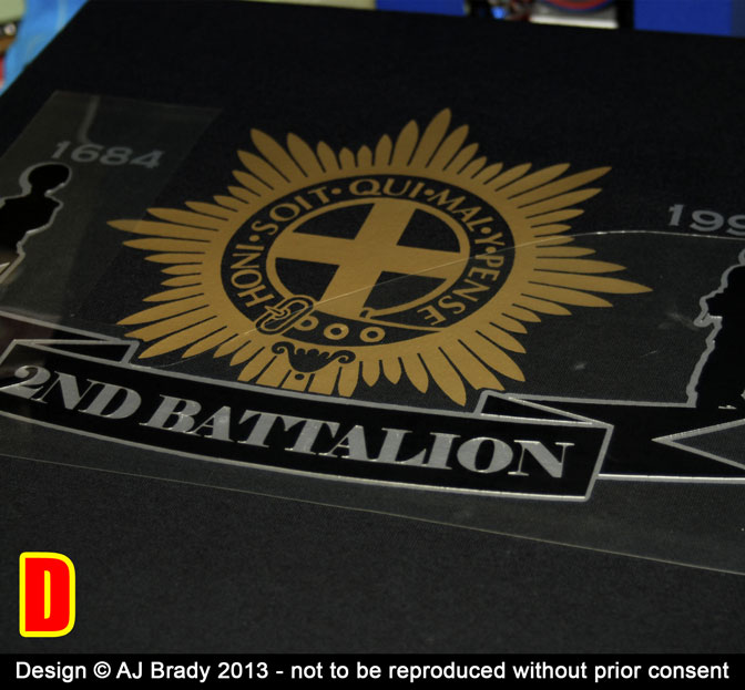

D: Next we have the black layer being placed onto the silver. Also, another note worth making is that vinyl will shrink if heated too much so it's a case of pressing for a few seconds to bond and then pull-away the carrier sheet.

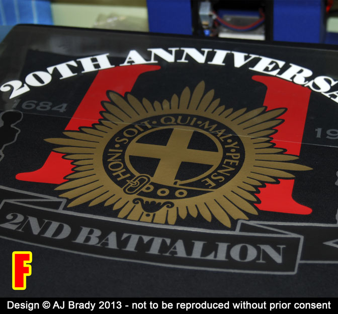

F: The first of the white layers in then pressed at the top of the design, and knowing that vinyl shrinks (remember stage D) it's a fine line to get it just right otherwise nothing will connect (i.e the bits won't connect on the final design).

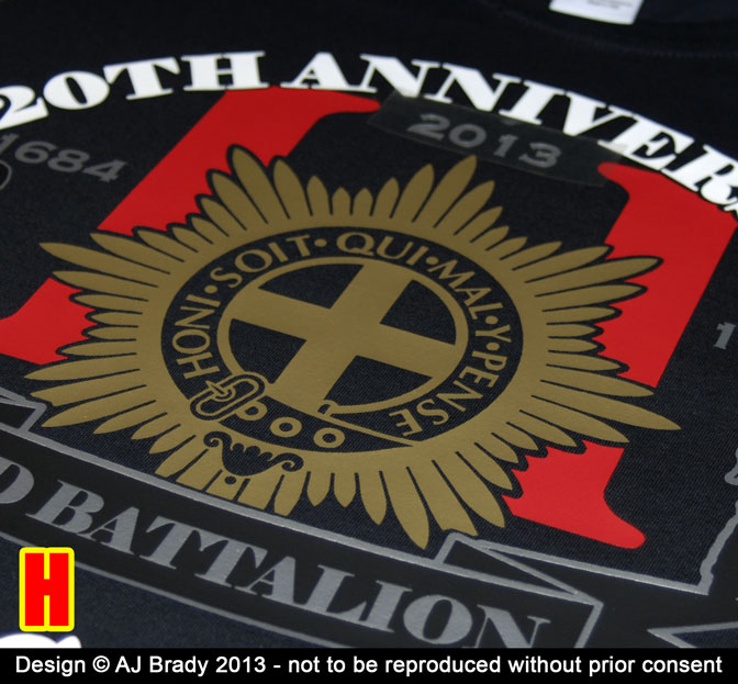

H: The final layer is the '2013' in Silver - which could have been done before the white but I chose to do this last.

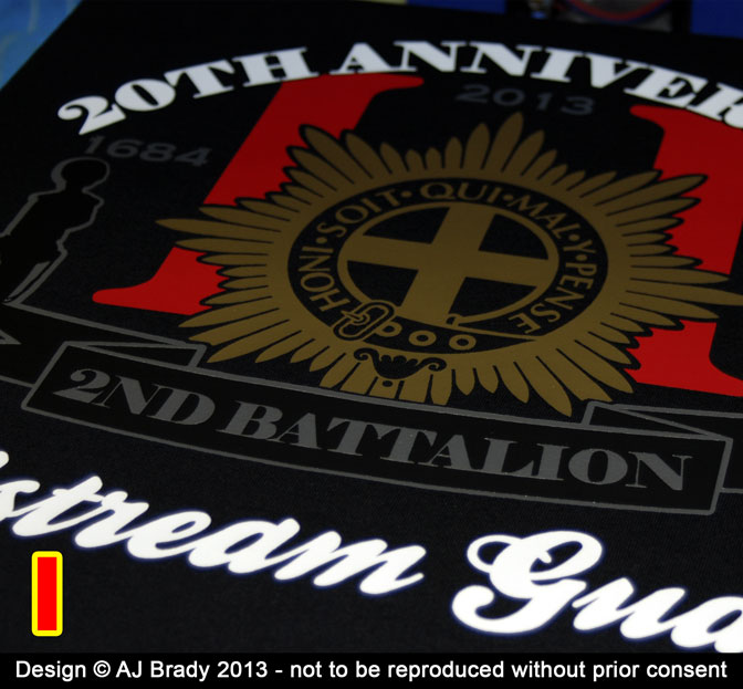

I: After all layers have been pressed the garment is then pressed for a longer period to make sure everything is bonded and secure. So, counting this final press I have now pressed this t-shirt 8 times (with all layers being covered by silicon sheets to avoid scorching).
