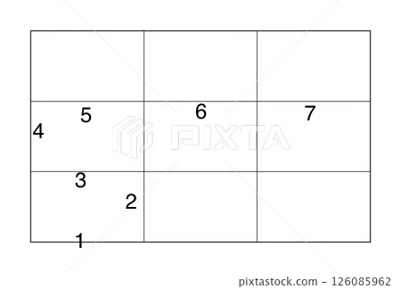

update:
It didn't work :(
What i have done.
split each box into separate lines
Joined the outer box into one single square
then joined the three vertical right, left and same with horizontal lines
I'm left with a box with a tic tac toe pattern in the centre, which is great with one issue.
It cuts in an odd way not line by line but outside box then a random path.
How can i change the cut order?

It’s cutting everything once which is great but not in order.
I think if it went in order it would cut a lot faster.

My mate Claude said----That cut order (1→2→3→4→5→6→7 as shown) is the classic "path optimisation" doing its own thing - the cutter is just jumping to whichever path end is nearest at each step.
**To fix it, reorder your paths in Illustrator's Layers panel to this sequence:**
The most efficient order for a 3x3 grid is to cut all the way across in rows or down in columns without backtracking:
- Outer rectangle first
- Top horizontal line (full width)
- Bottom horizontal line (full width)
- Left vertical line (full height)
- Right vertical line (full height)
That way the blade travels logically and lifts as few times as possible.
**To reorder in the Layers panel:**
Open the Layers panel (Window > Layers), expand your CutContour layer, then just drag the paths into the order you want top to bottom. The cutter reads them in that sequence.
**But the faster fix** is in your cutter software - look for an option to **disable path optimisation** or set cut order to **"as drawn"** or **"document order"**. That forces it to respect your Illustrator stacking order exactly rather than recalculating its own route.
What software is pushing the job to the cutter - is it Flexi, Onyx, or something else? That'll help pinpoint exactly where the setting is.

I gave up and re-made the file.
I created a new box then four lines selected all lines and named them all CutContour.
I put the box at the top of the layers and named the rest H TOP, H LOW, L VERT, R VERT.
Tested and it's only bloody cut it in order and working perfectly.
I have no idea what happened before but it's working now lol.
