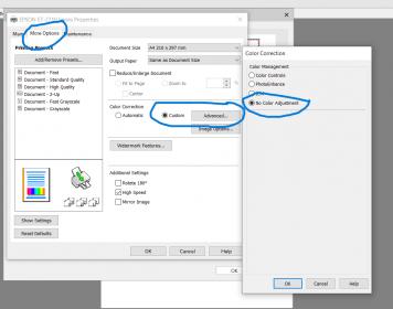

After you have done that then in the printers own properties dialogue box click the more options tab and under colour correction select custom and click the advanced button. Then check the no color adjustment box. (screenshot attached using ET2710 - yours should be similar).

[ATTACH=CONFIG]7412[/ATTACH]
