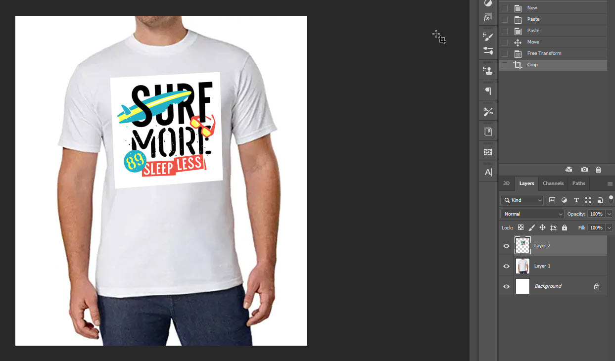

Re: sublimation t-shirts mock up help
Set your image layer mode to 'Multiply,' then further adust opacity etc as needed.
Start ...
[ATTACH=CONFIG]6836[/ATTACH]
After setting layer mode to 'Multiply and opacity to 65% ...
