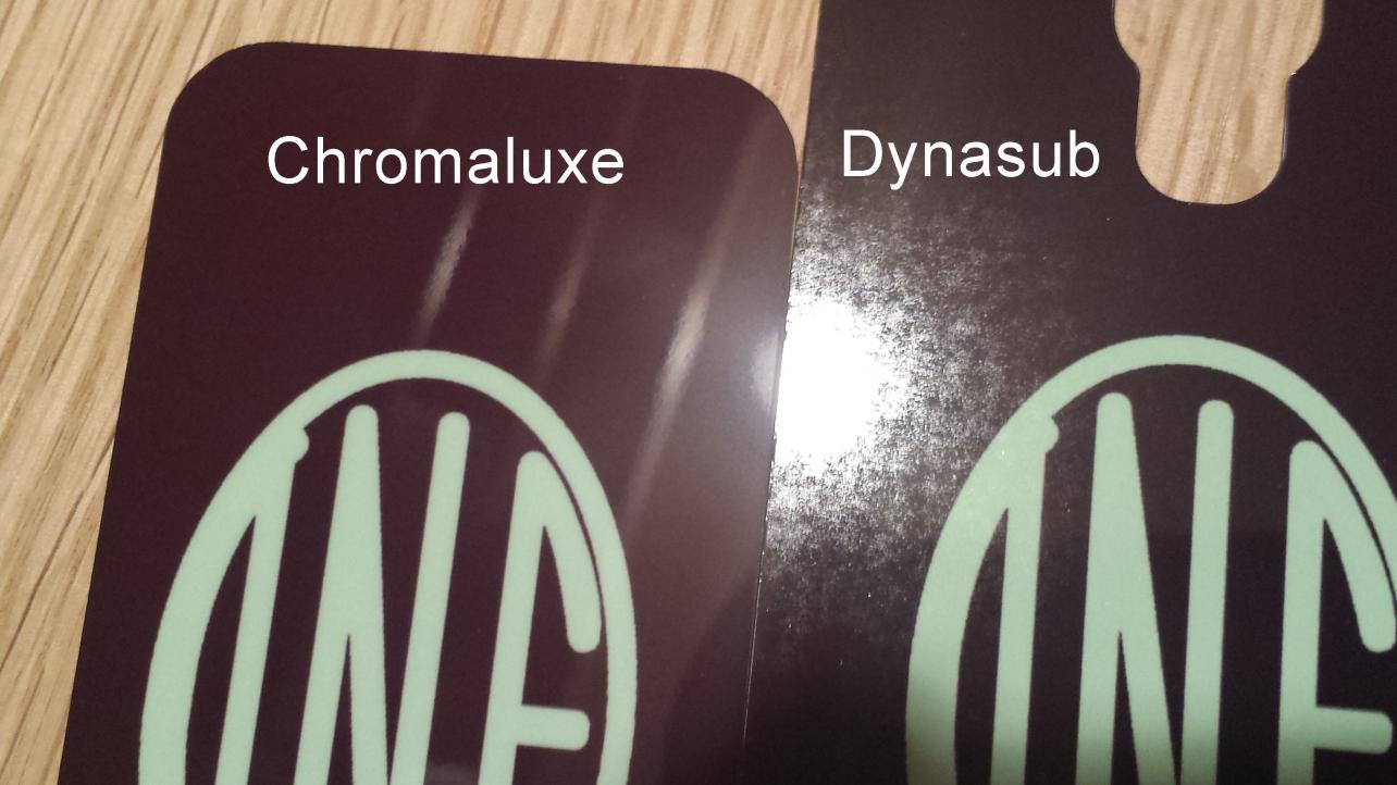

We see the "surface defect" on the blank slate. I guess the problem is the coating.
Moreover, on my digital alarm clocks, I also have this kind of stains, a bit as if the fibers of the paper melted in the coating (on aluminum plates, 30 sec at 180 degrees, very low pressure = improves things!)
I spotted this problem on the internet, we note the difference in quality between the 2 types of coating ...
[ATTACH=CONFIG]6798[/ATTACH]
vB_ID:6798
vB_ID:6798
