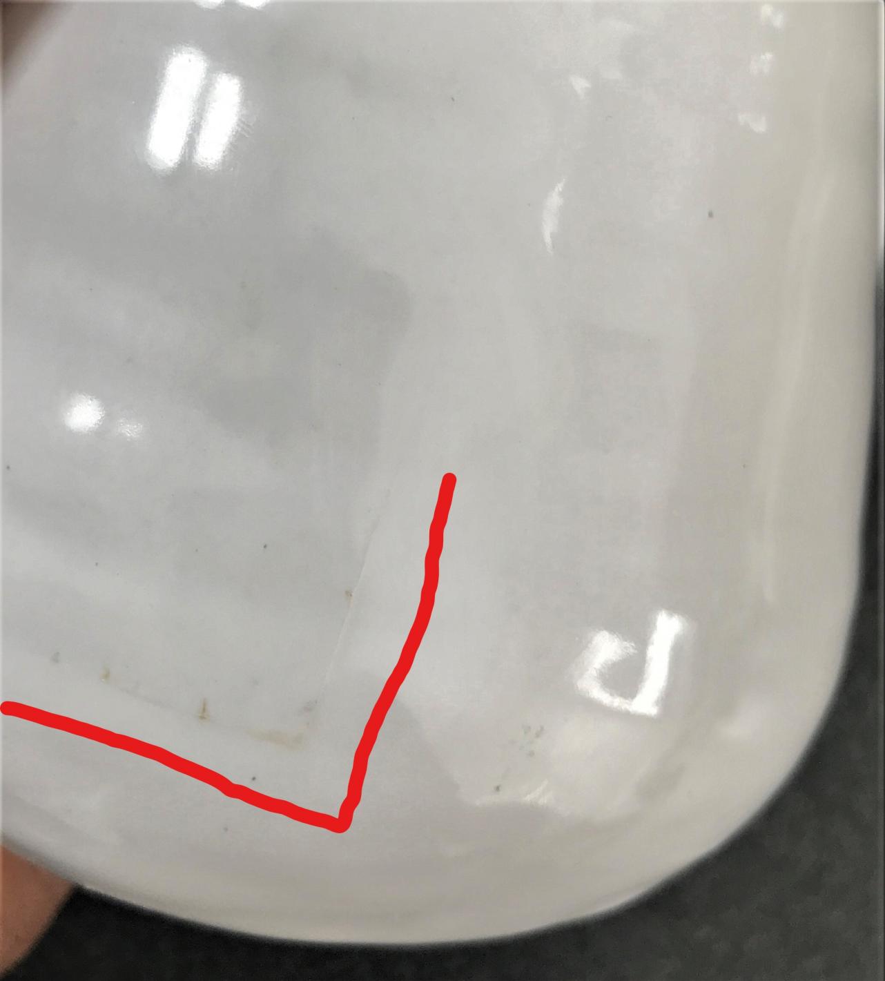

Because I saw a seller who personalize on the same planter that I have.
And more likely the planter is non-poly.
When I touched letters on the planter which the seller sublimated, I can't feel any bump.
So I guess the seller didn't use Vinyl method.
By the way, I looked closely, and I found some trace.
Can you tell me which method they used?
[ATTACH=CONFIG]6480[/ATTACH]

Re: What is the best way to print on planter, or flower vase?
Looks like a printed clear vinyl.
it’s just simply a clear digital vinyl which has been printed onto using a solvent printer or UV printer.
Waterslide transfers are an alternate option but not sure how long they would last outdoors.
