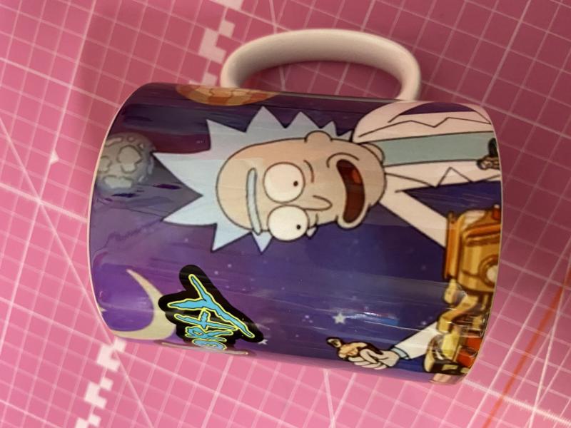

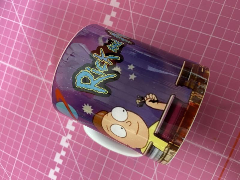

Can it do a full mug print:
Yes technically I do full mug prints allowing a gap for the handle Of course. (See images)

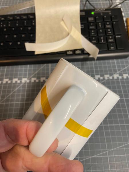

Taping the design:
I see so many people absolutely plastering their mugs and tumblers with kapton tape (heat tape) there's no need.
I add a small strip to each side of the mug (see below) and the pressure of the press itself holds the design in place so there is really no need for all that tape people.
