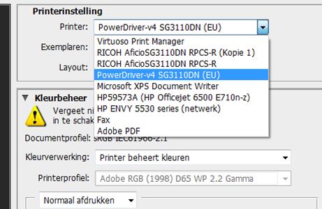

Hi, For Printer try selecting "Power Driver", I'm assuming that you have Power Driver from Sawgrass installed?

So I chose this one:
vB_ID:5461
vB_ID:5461
Nothing comes out of the printer :(
Re: Red is orange after press
'printer beheert kleuren translate' ............... does that mean 'printer manages colours?'
In Photoshop, it should be 'Photoshop manages colours.'

Yes that means that the printer manages the colours. I will change it and try again!
In the Sawgrass instructions it says that the printer has to manage the colours ...

Yes try Power Driver, that's what I use, ( I have Printer Manages Colors set)
