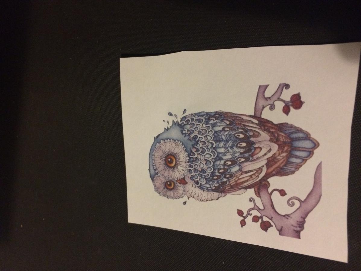

I *think* Im now getting somewhere as I did manage to get a print onto ceramic.
I've attached two photos-one of the print out and one of the item on a ceramic-I know they aren't sized properly at all but I was just anxious to actually get an item sublimated. I still think the subbed item looks very wishy washy. Any suggestions re this? Could it be something wrong in my AI settings-tbh I have fiddled quite a bit in them and they could still be off.
Last night I ran another nozzle check and it had bits missing so I ran the head cleaner a couple of times.
I also went back over installing my icc profile.

You are starting to get somewhere now but the final result is still pretty poor.
Can you supply a web link to where you got the sublimate tile / coaster from. Also what heat press temp and time are you using?
Alex
