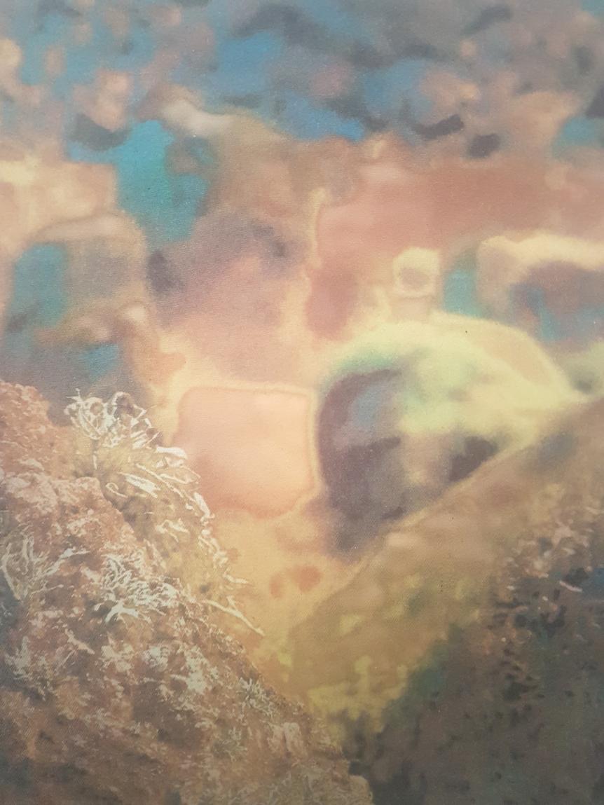

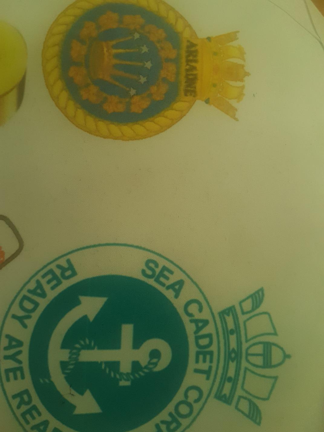

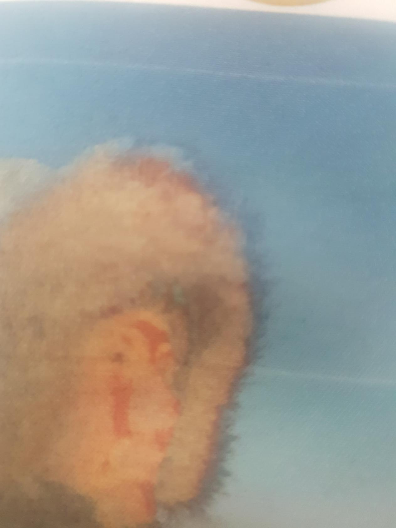

Good afternoon good folks of the DSF!
I've just got my kit setup (printer/press) and had a quick play whilst I'm waiting for new stuff to arrive...hey, it's all new to me - and you all suggest having a play anyway :biggrin:
So, I've bought a 2nd hand SG2100N printer with a press (laser thermometer shows that the plate temp is only a degree or two out from the displayed temp, and fairly even across it). With it came a variety of random bits and pieces that the previous owner never used.
Managed to get the printer installed (Windows decided it didn't like the drivers and refused to recognise the printer. A few choice words, a restart and a cuppa later...sorted).
Quick Google suggested 60 seconds @ 190C for the material I was using (it's a Christmas Stocking...perfect choice for February then...).
Did the usual printer routine (heads aligned and cleaned, paper loaded - right side up) and had a crack...here's the results:
From left to right: Original image (as taken on my phone), the printed & pressed image, a couple of logos (no prizes for guessing my hobby), a picture of my better half (she doesn't look that oddly coloured in real life...honest) and an overview of the first test print I did.
As you can see, the photos have no depth of detail, and the colours are a little...out of whack. Whilst it could be argued that it's "arty" - I would prefer to have detailed images. The logos aren't too bad - little bit of bleed on the Ariadne image (I suspect that might be partly due to it not being a particularly good image to start with). The Iron Oars logo has come out looking very close to the original image - a little bit faded, but still easily recognisable. The pound sign was a random image I found on my laptop and is probably the most successful of the bunch.
Sorry for the long post, however, I'm hoping that details will help diagnose the issues I'm having.

Re: Printing issue
Hi,
it could be you are printing on the wrong side of the paper ....
Do the wet finger test, - sticks more to the correct side
Also- 190c I hope - F is too low!

Re: Printing issue
I'm afraid you've possibly identified the issue yourself. You don't know how old the ink is so I'm guessing you don't know what type of ink this is? You must have a profile installed or you don't stand a chance. You can follow installation instructions for a 3110 on Sawgrass website to get you in the ball park and also software config.
My advice would be to dump the printer and start again but I appreciate that's not always an option. You need to get back to square one, will the seller help you to identify the age/type of inks? You will need a profile making if you can't get one. There may well be someone on here that could send you a profile but without knowing ink and paper type it may not help.
Out of interest, have you done nozzle checks?

Re: Printing issue
What printer are you using and software.
It looks like your vector artwork is printing ok and reasonably sharply but your photographs are printing at very low resolution.
It could be a printer setting or possibly that you have 2 printer profiles operating that is causing a problem with correct printing of more complex photo graphics.
This can happen when you have a printer profile provided by the graphics software you are using and also the printers own profiles. You need to switch one off.
If it was the wrong ink, paper or temp etc then it would impact both vector graphics and photos equally. The sample you show indicates that main problem is with photo resolution and that I suspect is either printer profile conflicts or even filters being imposed somewhere.
My first suggestion would be to go into your printer advanced settings and turn off auto colour profile and set to no icc profile if that option is available and try another test

I tried the wet finger trick on the paper, and suspect it may very well have been in upside down...oops...
Starting afresh isn't a viable option at the moment - and this printer hasn't printed much at all according to the counter (about 390 pages). It's on the agenda if things go well enough!
I've run through the head alignment and head clean (and flush) which has improved the banding issue massively.
Appreciate the help & advice guys - got some tinkering to do later!
I have new inks (with a 'profile on order) - and some new paper! So the stuff that is in there is going to be ditched! The seller wasn't sure how old it was - she's recently gone back to college (studying nursing) and has 2 young kids - I was impressed that she was still awake!!Justin;129940 wrote:I'm afraid you've possibly identified the issue yourself. You don't know how old the ink is so I'm guessing you don't know what type of ink this is? You must have a profile installed or you don't stand a chance. You can follow installation instructions for a 3110 on Sawgrass website to get you in the ball park and also software config.
Now you mention it, that is a good point! It's just a little SG2100N running with the standard driver package and printed from Inkscape and GIMP. Haven't had chance to play yet today, might go do so after tea!!Customprintwales;129941 wrote:What printer are you using and software.
I hadn't done a head clean & flush at that point - that did improve considerably.webtrekker;129965 wrote:You also seem to have some banding issues on the picture of your partner.
