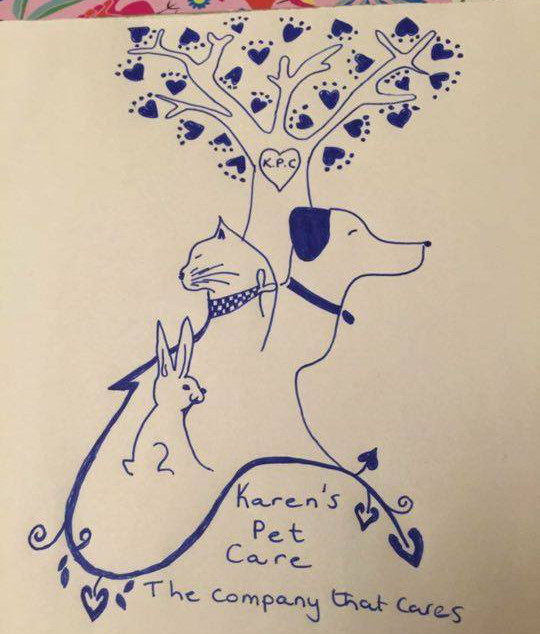

Why use a different material for the globe? Can't the BN-20 print all the colours and then cut it? If the detail is too fine I would say to the client it is to fine and would they be happy with losing the smallest dots. I had to do this one recently using MDP Hot Flex and had to lose the smallest dots around the hearts. My client was fine about it.
