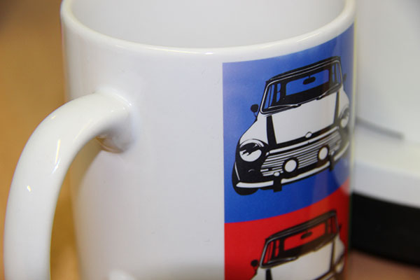

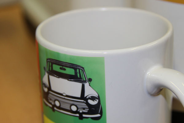

Ours works great for white background designs.
I pre-heated the base of the mug for 30 seconds before applying a full coverage design. The bottom came out perfectly but the top corners were still soft. I tried lots of different temperatures, right up to 190C for 220 seconds. The corner was still soft and there was browning on the front of the mug. I couldn't produce anything salable with a full coverage design.

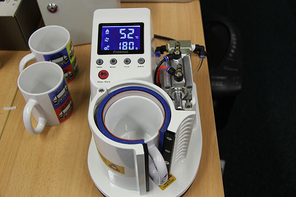

Oh and it's a BestSub ST-110.

To preheat the base you just put the bottom inch of the mug in the press for about 30 seconds, then take it out and apply your transfer.
The base is thicker so takes longer to heat up. This just gives it a head start so it should be the same temperature as the rest of the mug by the time it's fully heated.
