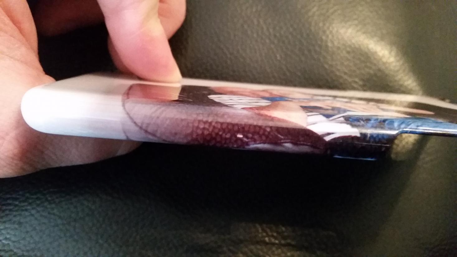

gibo78
Posts: 10
Joined: 30 Dec 2015, 01:16
Re: Use film with ST-3042 ?
Post by gibo78 »
[ATTACH=CONFIG]3800[/ATTACH]
Looks mottled. Looked the same inside the film when removed
vB_ID:3800

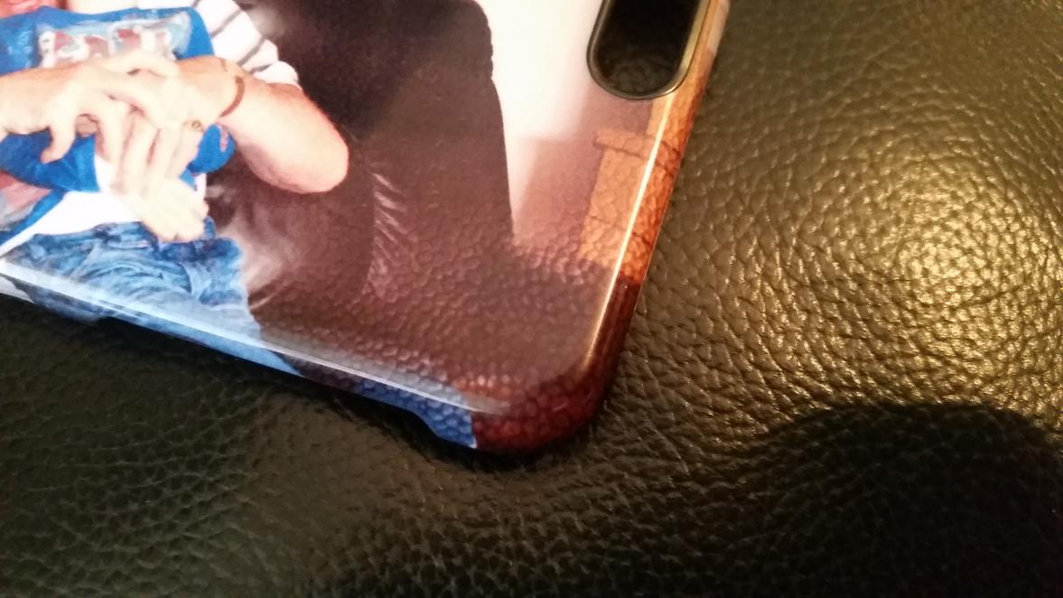

gibo78
Posts: 10
Post by gibo78 »
[ATTACH=CONFIG]3801[/ATTACH]
Can see better here. Transferred fine on other end of case
vB_ID:3801
vB_ID:3801
