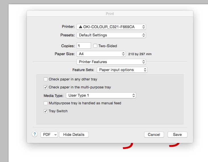

Hi again this is what works for me
First i checked the Paper feed was set to Multi-purpose Tray,
Then I selected Printer Features, Feature Sets, Paper input options, and used the settings shown in the image below.
If you click the box where it says Multipurpose tray is handled as manual feed, you will have to press the Online button on the printers to get it to print.
hope this helps
