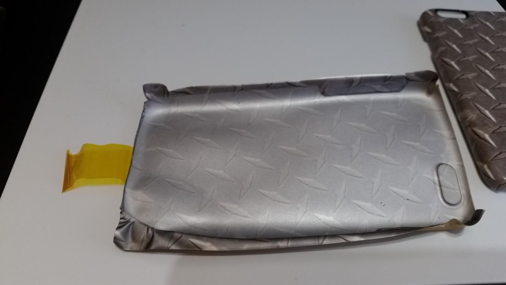

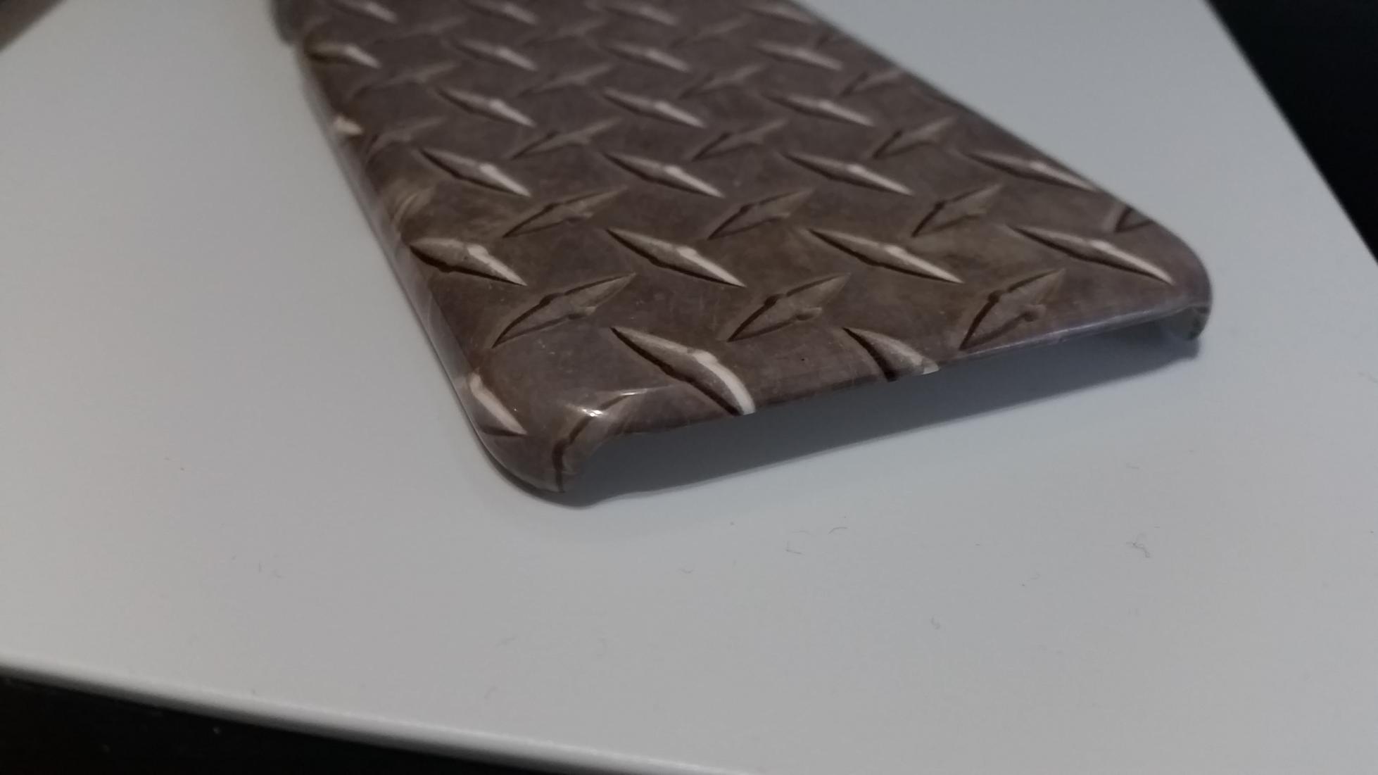

[ATTACH=CONFIG]3802[/ATTACH][ATTACH=CONFIG]3803[/ATTACH]
Inside film was all cracked on last one

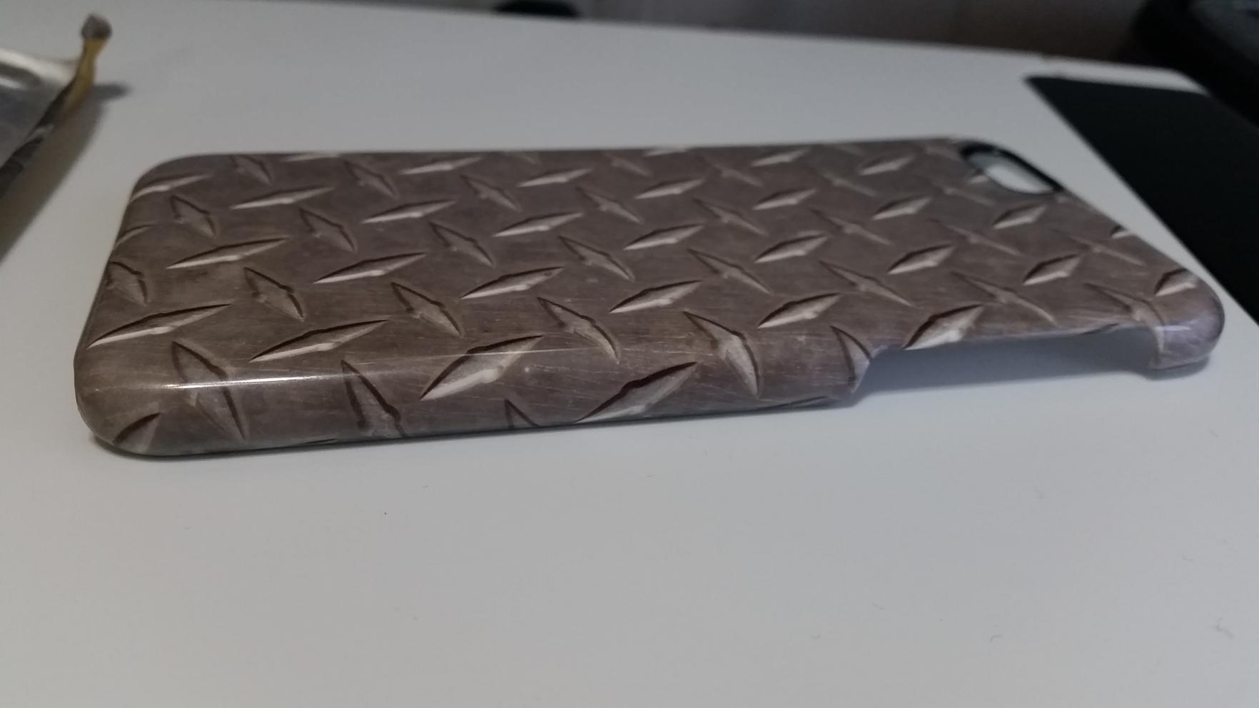

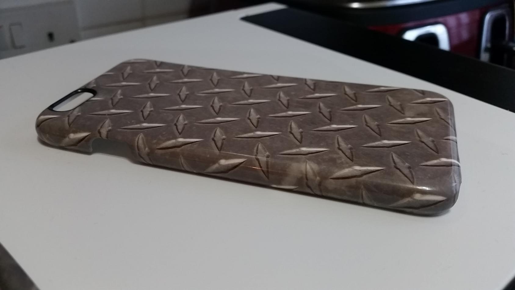

[ATTACH=CONFIG]3804[/ATTACH][ATTACH=CONFIG]3805[/ATTACH]
I only taped the short sides and trimmed close to just what was needed

I saw somewhere that you can adjust pressure on 3042 but that it's preset at factory so shouldn't really be touched. Anyway, this one came out nice but obviously need to keep repeating result to be sure
