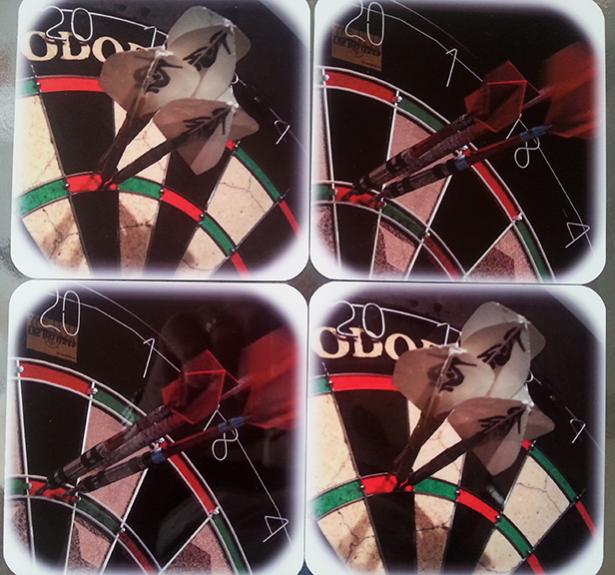

These are high gloss. I'm going to try again today & let you know what happens.
AZCanuck
Posts: 8
Joined: 02 Apr 2014, 19:14
Re: Cloudy transfer
Post by AZCanuck »
Well people, problem solved! It must have been the time, I think it was approx. double what it should have been.
This set turned out beautiful!
[ATTACH=CONFIG]2638[/ATTACH]
Thanks for all your input, it was very much appreciated!!
