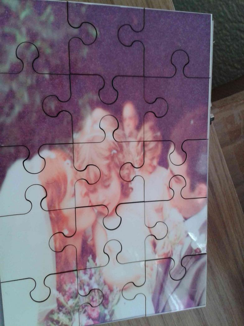

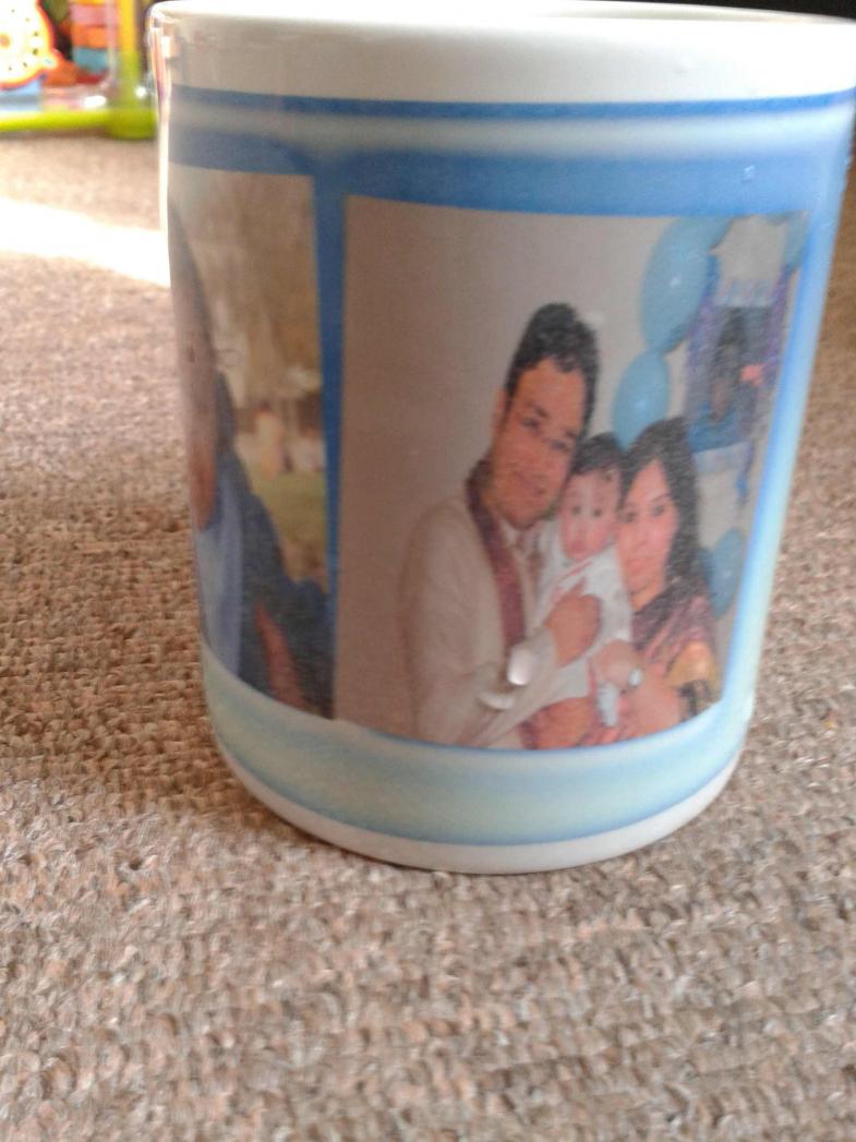

Hi All,
I have recently has started printing Business. Bought SG3110 from BMS and use trupix paper for sublimation print. It was going fine but from last night I was trying to print Mug and jigsaw but all of them are faded as follows. Don't know what to do. was trying to change pressure and temp but same result. Could you guys help me to find out. Thanks in Advance
[ATTACH=CONFIG]1976[/ATTACH][ATTACH=CONFIG]1977[/ATTACH]

Re: Ricoh SG 3110 Faded Black Problems
Are you printing with the 'powerdriver' profile? If not the colours will be poor.newbi;77373 wrote:Hi All,
that looks like wrong side of paper like paul mentioned earlier did this on a mug for first time n my ricoh (too stupid to realise glossy side down lol) and my mug looked just like that
