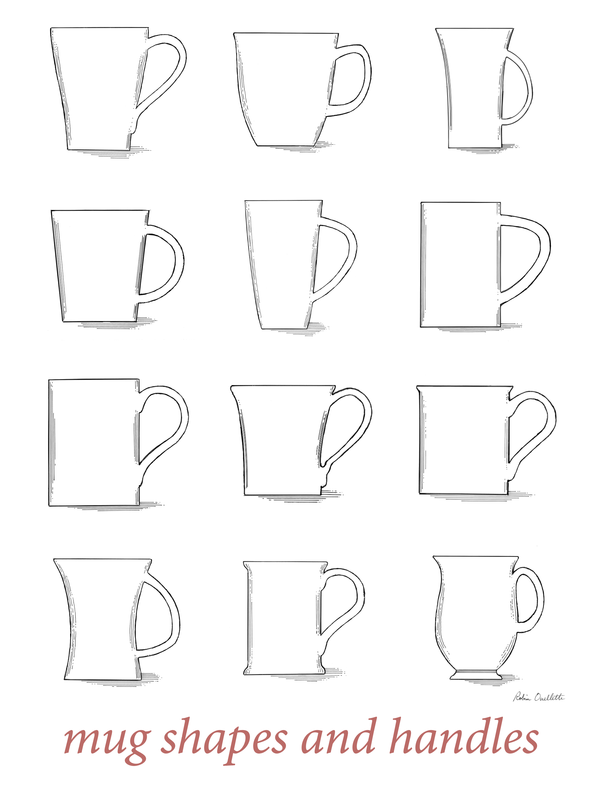

mug shapes.png (832.41 KiB) Viewed 8275 times
So all of these shapes are printable, presuming they have the correct coating?

Anything involving a curved surface would be a challenge. So straight and tapered sides do-able. Curved profiles would need somebody else to chip in.
