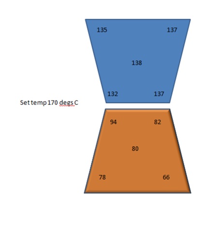

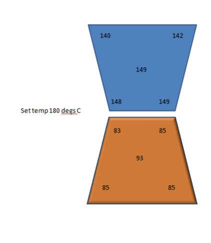

I have done a temp check, and i am thinking the heating element is not the same as the reading on the screen.
PW66 - i did up the temp and here's the results.... again, not sure what i am expecting the variance to be between the temp on the plate and temp reading on the display.
[ATTACH=CONFIG]7428[/ATTACH][ATTACH=CONFIG]7427[/ATTACH][ATTACH=CONFIG]7429[/ATTACH]
I suppose if the element is on the way out i will need to go off the gun temperature and not the digital display, so for hotflex, set the machine to 195 maybe and check the plate with a gun until i am getting 160 degrees C.

- vB_ID:7429
- Heat press 190 degs C.jpg (17.47 KiB) Viewed 2752 times
- vB_ID:7428
- Heat press 170 degs C.jpg (17.28 KiB) Viewed 2752 times
- vB_ID:7427
- Heat press 180 degs C.jpg (17.12 KiB) Viewed 2752 times

That is all you can do. There is obviously a mismatch between the thermostat and the element somewhere - it could be the element failing or just a faulty thermostat.
