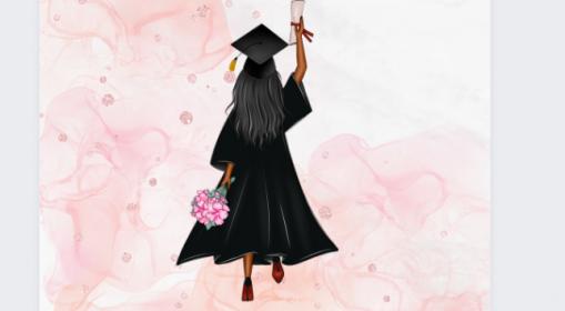

Designed in Canva (image 1) and saved as PDF. When printing straight from the PDF we are aware there are no ICC profiles being used (at least with Canva anyway). We print on Versa paper from IE, using Sublinova Inks. When printed the colours are very similar to the screen such as the pinks and cream/ grey background (and are happy with what we see generally). However the print for the graphic in the middle in black (image 2) is mottled/ blotchy on the print alone - no pressing as yet. We are aware that there will be differences from Image on screen, to when it is printed, to when it is pressed. But this part is supposed to be jet black or at least black, but when printed you can see it is slightly browny/ blonde and not so black - This is where we feel we should use a design software in order to utilise the ICC profiles we were given - but had not done at this point.

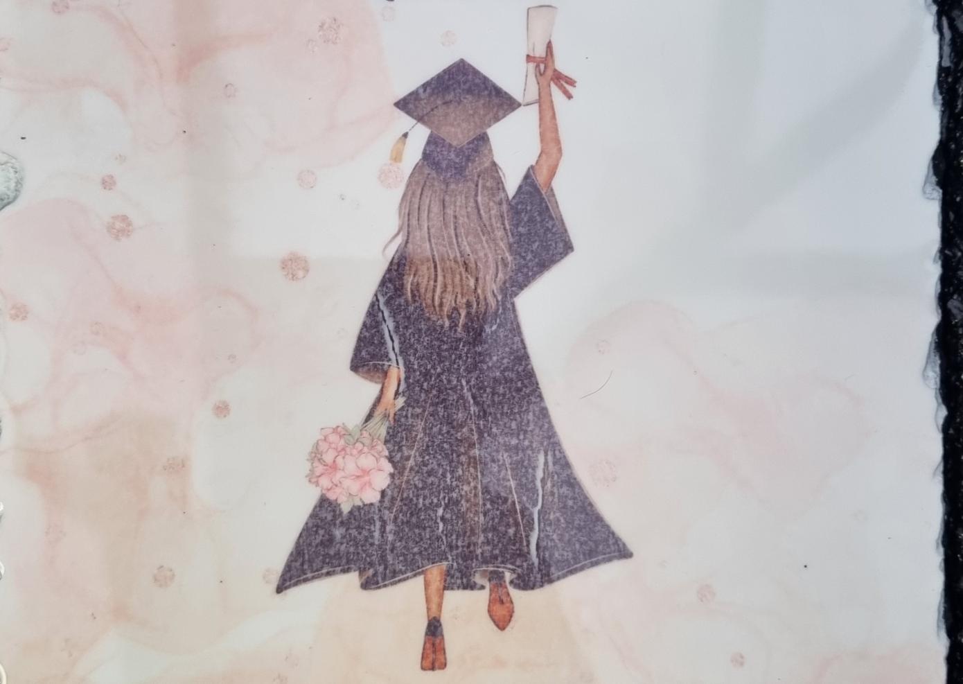

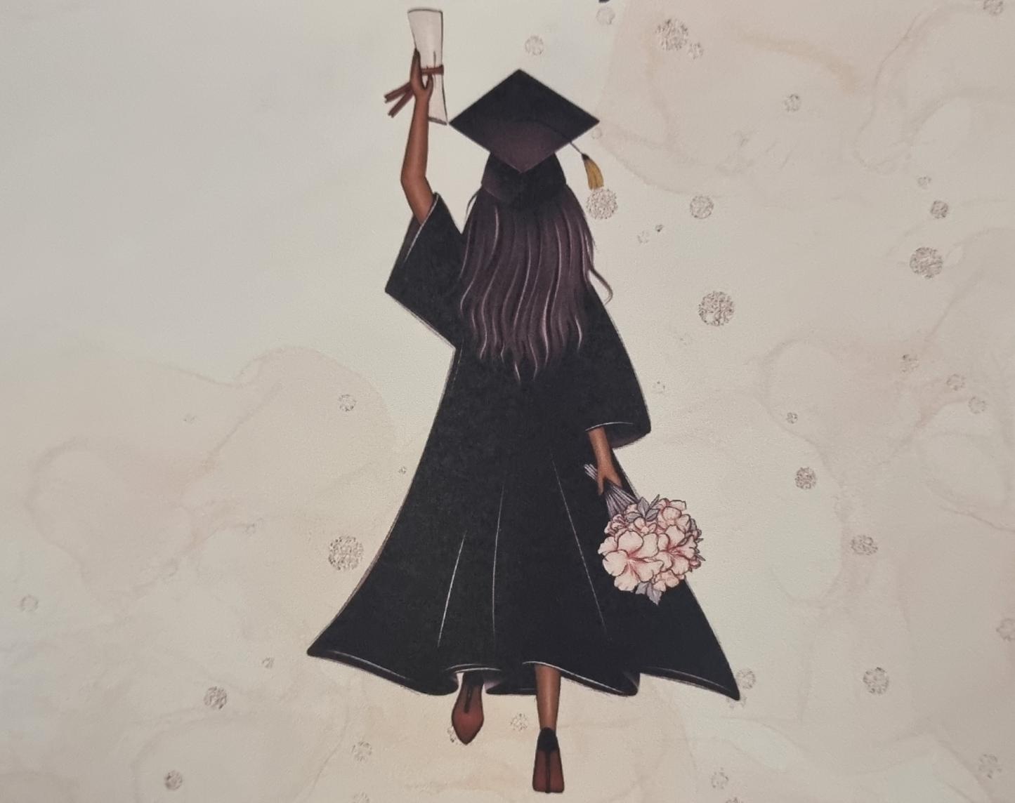

When pressing onto slate (image 3) you see the graphic doesn't look black and is very mottled, and now looks blonde, even the gown.

195 temp for 550 sec - image in middle mottled and does not look black (image 3 again)

We still feel there are issues with the ICC profiles as the colours are not correct. If you look at image 2 - the print out looks almost brown/ blonde and not black. This is what initially made us think that we needed to use ICC profiles for sure, and when we did, the colours all changed.
