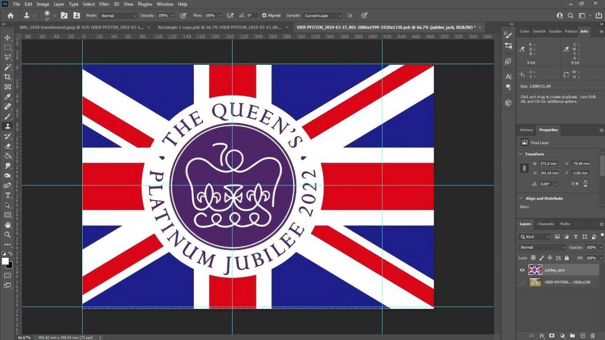

You just need to use a Smart Object with a Layer Mask then you can use any mouse mat product image that you like and alter it yourself. Here is the image you supplied ...
[ATTACH=CONFIG]7195[/ATTACH]
The Smart Object can then be changed to another image ...
[ATTACH=CONFIG]7196[/ATTACH]

I've uploaded the PSD file here if you want to play around with it - https://webtrek.co.uk/mouse_mat_mock.psd
[Note: When in the Smart Object, turn on the Guides (Ctrl+;)to help centre and position your image, then use Ctrl+S to Save before returning to the main Mockup file].
