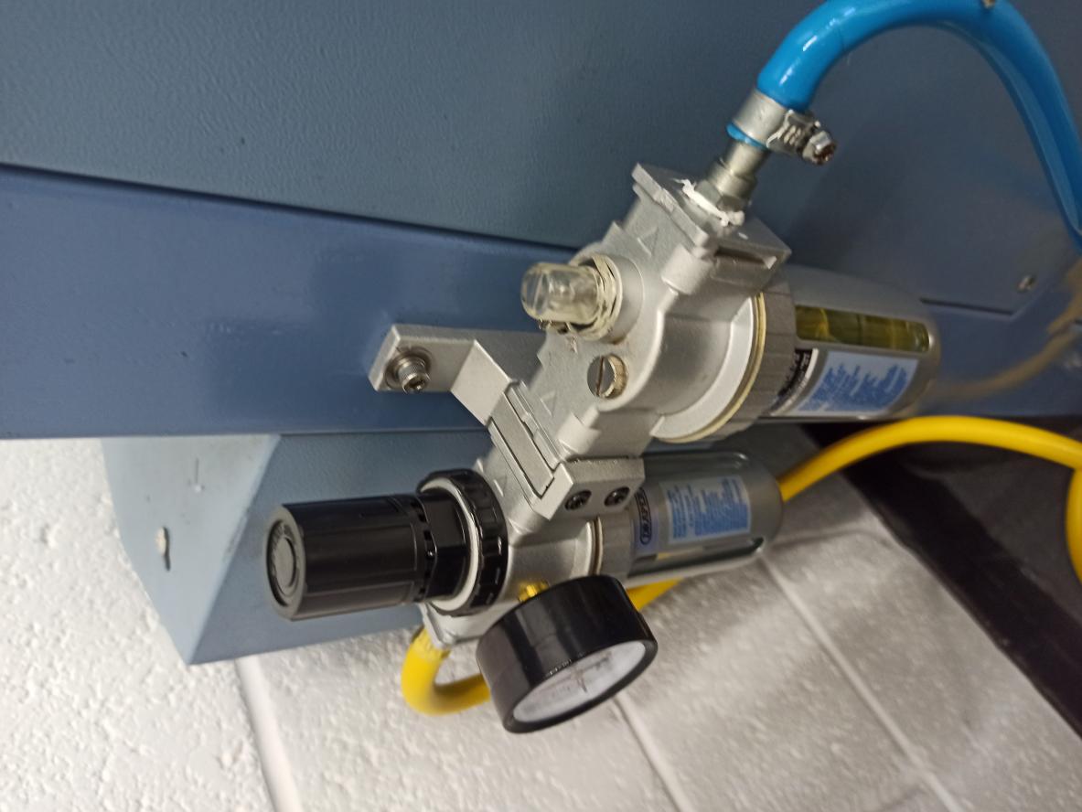

Previous owner thought around 125psi. I didn't get a compressor with it but have one for another press that I've been working with. I fitted a new air regulator, it's leaking air and stopping the machine get to the right psi, not sure if it's faulty or deliberate yet......does yours use one like attached by any chance? Leaking through the little plastic bit shown on close up, it has a couple of small o rings but doesn't tighten incredibly well like it's not designed to so not sure if leaking is deliberate.

Just got one of those smaller presses as well, pretty much same but it's the one Mega stock. Compressor works fine on that one. Small plastic dome is definately stopping the pressure going to the machines, will have a chat with local pneumatic company thanks.

Quick update, second new air regulator working properly and press all fine now
