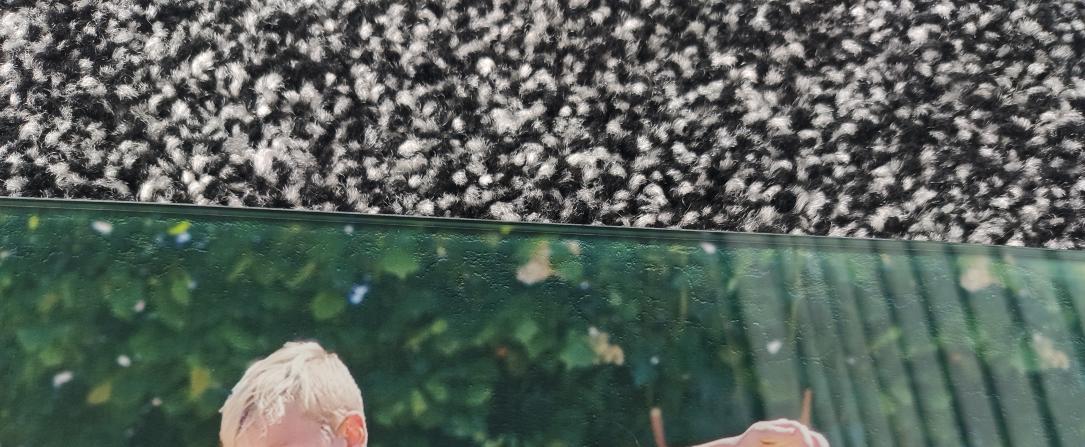

Hi there, i am new here, i heatpress mainly as a hobby, i recently got some sublimation chopping boards where you heatpress the image on the back so it shows through the front, BUT every chopping board has print issues where it looks like big blotches on parts of the photo/pictures, i secure the paper to the chopping board with bits of heat tape as normal so i am not sure it is because the paper moves, here are pictures of what i mean
so far i have wasted 5 chopping boards lol as the final thing is not really good. also this has happened on a round glass clock face

What printer/inks/paper are you using? Time & Temp, pressure of press etc?

i am using a epson wf-210w with those refillable ink cartridges in as i had a ecotank but it was useless as i never used it enough and the ink kept getting clogged and knackering the print head.Justin;149125 wrote:What printer/inks/paper are you using? Time & Temp, pressure of press etc?
I don't do any glass, pain in the arse.
i use cityinkexpress sublimation inks and their cream sub paper. on everything else it has all been fine its just with these glass chopping boards and the glass clock face i get this odd issue
the temps i use are what i sstated from where i got these sub blanks from which is subliblanks, 180 seconds and 190°C temp

definitely try upping the time/temp/pressure as it looks like it needed a bit more
Also, try pre heating the glass panel with blank normal paper to absorb any moisture
Make sure the ink is dry on the transfer paper before using (and the transfer paper itself it dry, not damp from where it's been stored)

Thanks Everyone i found out my issue lol i messaged the place i get the chopping boards from....i needed to pre-press the chopping boards to get rid of any moisture, they said to put a piece of white printer paper over the top of the side the image will be pressed on then press it for 5 seconds each time, do it a few times, as soon as i did this i could see where the moisture from the chopping board had gone into the white paper, this is why those horrid patterns on my finished items had the patterns randomly all over.
i did this pre-press 4 times and did a chopping board with a image i printed and its perfect lol.
