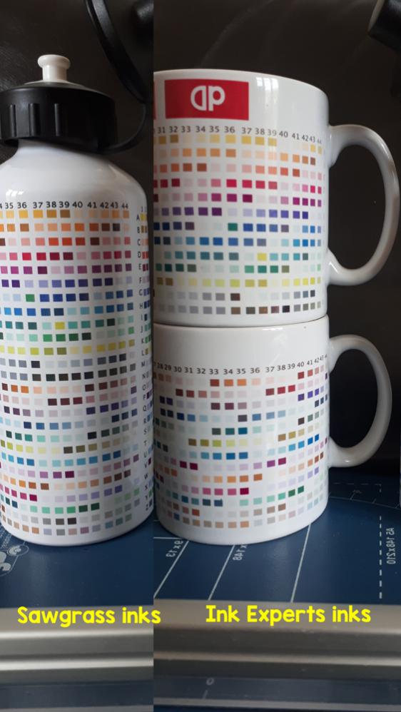

I didn't feel I was exaggerating but I just timed it printing a busy-ish A4 and it took 3:38 mins so 5 times longer than with Power driver. The colours are not totally out I've attached a colour chart comparing results. But you can see the colours are not as vibrant and printing not as sharp even with the extra print time. I want a vibrant red like I'm used to but can't get one using their ICC, they come out pinky or dull compared to Sawgrass. If I use Power Driver with the InkExperts ink I get the right colour but it is banded. So the ink has the potential to produce the vibrant colour but somehow the ICC is 'stingey' with the ink and disappoints.[ATTACH=CONFIG]6749[/ATTACH][ATTACH=CONFIG]6750[/ATTACH][ATTACH=CONFIG]6751[/ATTACH]socialgiraffe;149007 wrote:it sounds like there is something wrong somewhere.
