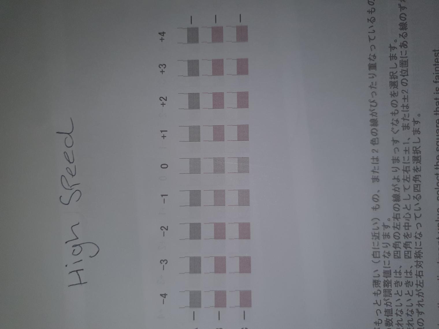

Hi, I have a problem with my printer Ricoh 3110,
Its printing with horizontal lines' the lines are not always in the same place and move from print to print.
Has anyone had this problem and know how to fix it.
I have tried head alignment and paper feed adjustment and cleaning the encoder strip with no luck.
Thank you for reading my post.
Lines Ricoh 3110

Re: Lines Ricoh 3110
[ATTACH=CONFIG]6602[/ATTACH][ATTACH=CONFIG]6603[/ATTACH][ATTACH=CONFIG]6604[/ATTACH][ATTACH=CONFIG]6605[/ATTACH][ATTACH=CONFIG]6606[/ATTACH][ATTACH=CONFIG]6607[/ATTACH]
Sorry, I don't know why all the images rotated after I uploaded them,
As you can see from the last image the lines move from print to print.
The lines only appear in small clusters that move and only appear on the first half of an A4 size paper.
So I don't think it's the ink' and I have changed the paper so it's not that.
Thank you for your help
Regards
Charlotte
Problem solved.
For anyone with this issue,
Solution was to adjust the paper feed in my case just by +1. Then to do a head clean.
If you adjust the value with no head clean it would still showed lines
I messed with this for days adjusting the values and cleaning the printer out, I was about to throw the printer in the bin.
