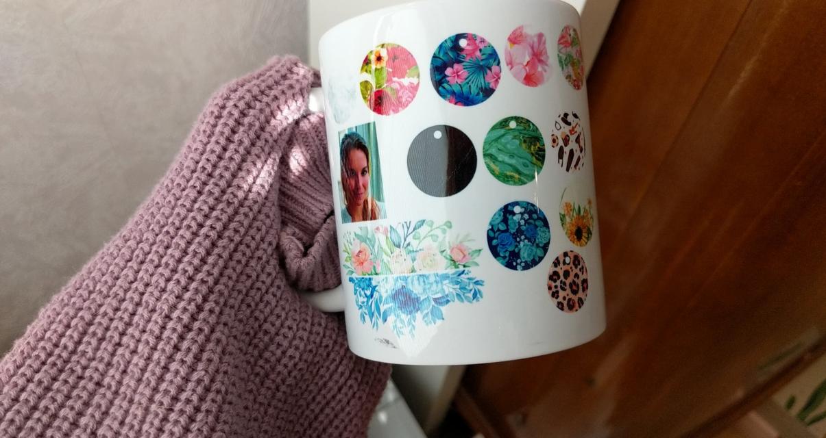

Hi guys so i have an EPSON WF-2630 and im working in Photoshop cs5 (64bits) and im using a twin mug press.
But from no where the colors have suddenly changed when i pressed the exact same print on a mug bought at the same time from the same supplier.
The right one on the photo is the original one, the left one is the sudden change in color.
It seems like all colors on all my mugs are much stronger.
Any ideas what has happend? I want it back the way its supposed to be.
I have not changed ink, paper, time, temp, mug, settings. Nothing i can think of, if i have not accidentally pressed something.
Any ideas?

Looks like both magenta and yellow are blocked. Try a head clean

I did a cleanse and printed out a color page everything looked fine
Tried pressing again and its still something that has changed, i dont know what. Its like everything has a red filter or something

CMYK? You should be printing RGB.

Yeah i just ment that i printed out a sheet with all the colors to see that they look fine :)

SOLVED!
So it seems like i had to change pohotoshop setting from Relative Colorimetric to Perceptual
Dont know why since i have used Relative Colorimetric since the beginning and never changed it. But what works, works i guess :)
