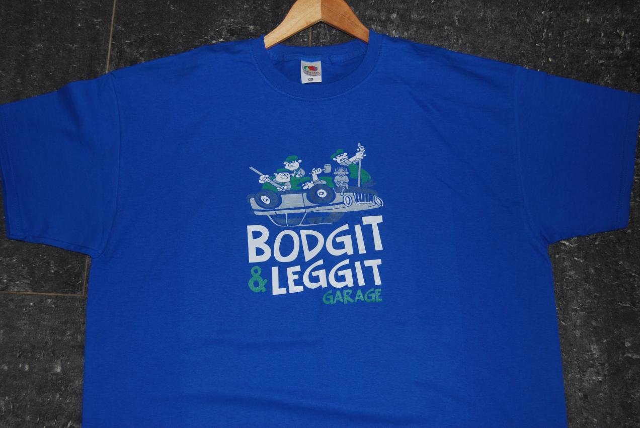

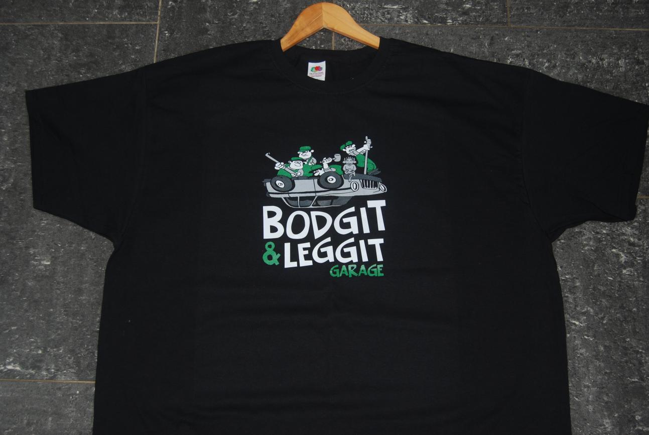

Hi Logobear, I purchased this equipment a while ago and just wanted to play with the dye-sub side of things a little, the grandkids they will not care as long as we are messing and playing. The dye-sub shirts were thrown in with the purchase deal so nothing to loose. I was just enquiring to see what might be my best option to get a kids drawing to a printed t-shirt.
I have printed around 6 shirts with the white oki using the 2 part forever system, as you say it's a learning process. Attached are two of the said shirts, it's a logo / brand for a youtube garage.

well it looks like you have got it right.
Have fun!
