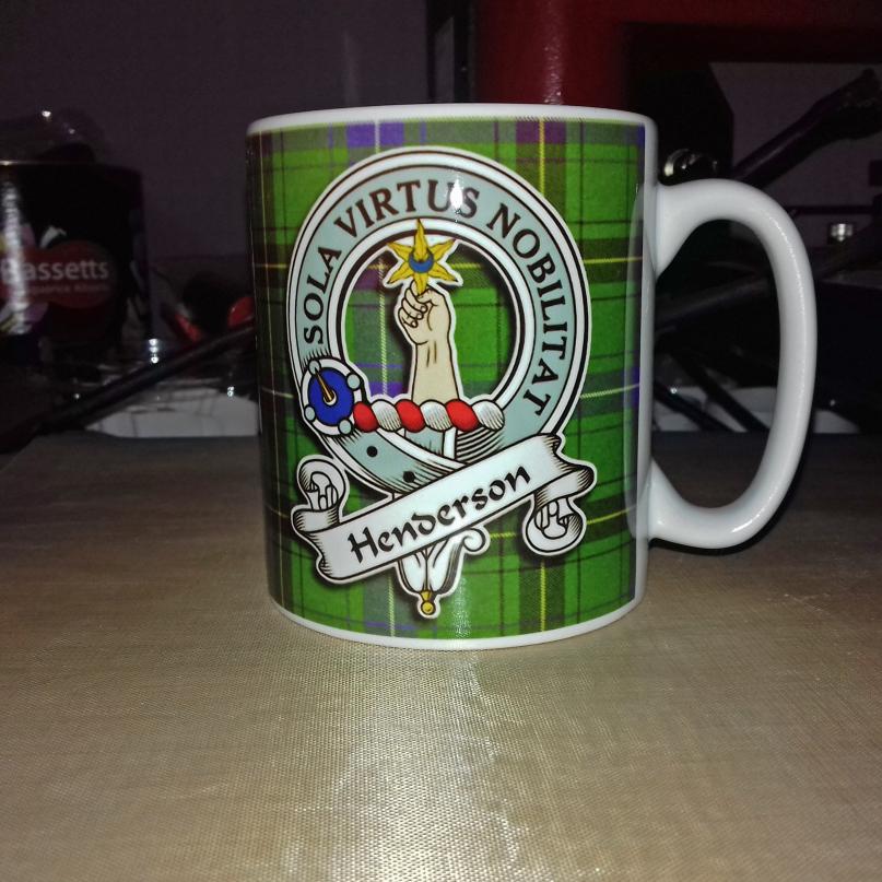

I have to say, my mug presses are nothing special, but they print Listawood 10oz mugs fine with an 11oz blanket. Saying that though, I do now use a halogen oven as, even when not doing a full-area print, it does allow a 'safety margin.' I too just use the green silicone wraps from ebay and find them fine. You need to experiment with an oven when you first get one as the temperature dials aren't that accurate, but once you find the correct setting and times then you can get some nice prints.
This was my very first attempt in my halogen oven ...
I now prefer to leave a slightly wider white border, top and bottom, but can get very near the handle, with a nice sharp edge to the print.
