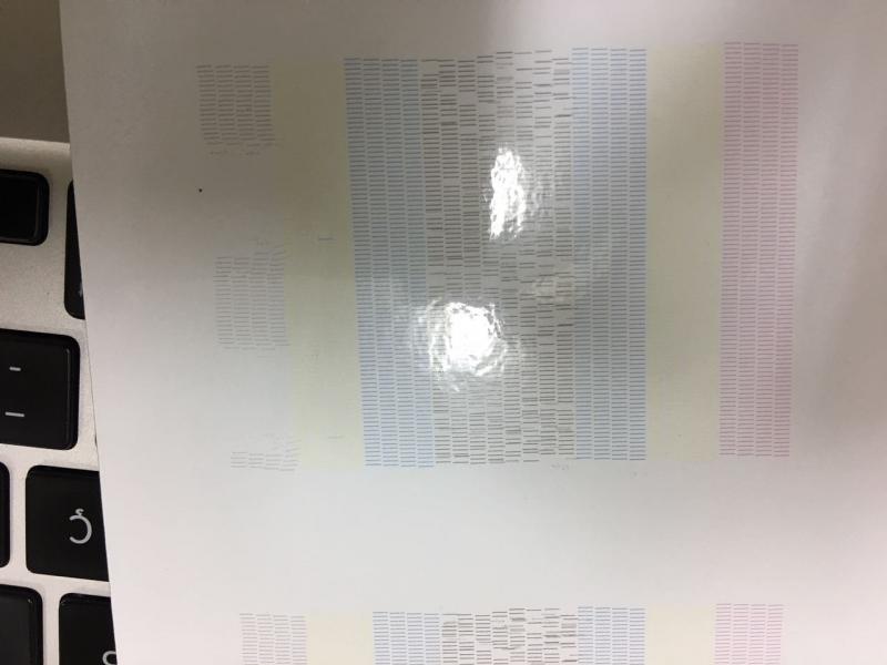

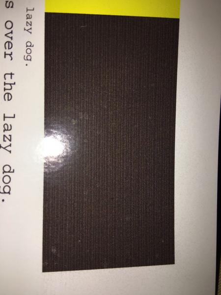

Hi,
i have a similar problem. I bougth a second hand BN20 :-D. I changed from eco-sol max to max3. And then we tried the firsts tests. And the print quality is bad, especially the Black print (See attachment). I did all kind of maintenance and cleaning (a lot of material and ink wasted), but until now the situation is the same.

STAY WELL AWAY from Max3 it dries too quick and blocks the heads, Also problems with media adhesion as it dries so quick it has not got time to bond you need to use media that is designed for Max3.

Before you changed the carts, was it printing OK? or did you buy it with no carts fitted?
Re: Roland Versa Studio BN-20 Printing issue
I believe you need change the firmware before you instal eco sol max3. have you done that?
Dont waste any more ink and media. call ROLAND customer service and tell them what is going on after you upgraded.

ArferMo;125404 wrote:STAY WELL AWAY from Max3 it dries too quick and blocks the heads, Also problems with media adhesion as it dries so quick it has not got time to bond you need to use media that is designed for Max3.
Hi ArferMo,
i think is too late to stay away. Now i have to find a solution.

scotty44;125413 wrote:Before you changed the carts, was it printing OK? or did you buy it with no carts fitted?
Hi scotty44,
I bought with no carts fitted and was missing the waste ink tank.

Paul;125416 wrote:I believe you need change the firmware before you instal eco sol max3. have you done that?
Hi Paul,
i did all the steps required by roland to install eco-sol max3.

S2DZ;125424 wrote:Hi Paul,
call them, and tell them your results. only coz your printer second hand no mean you will be left with no help. I found ROLAND very helpful.
