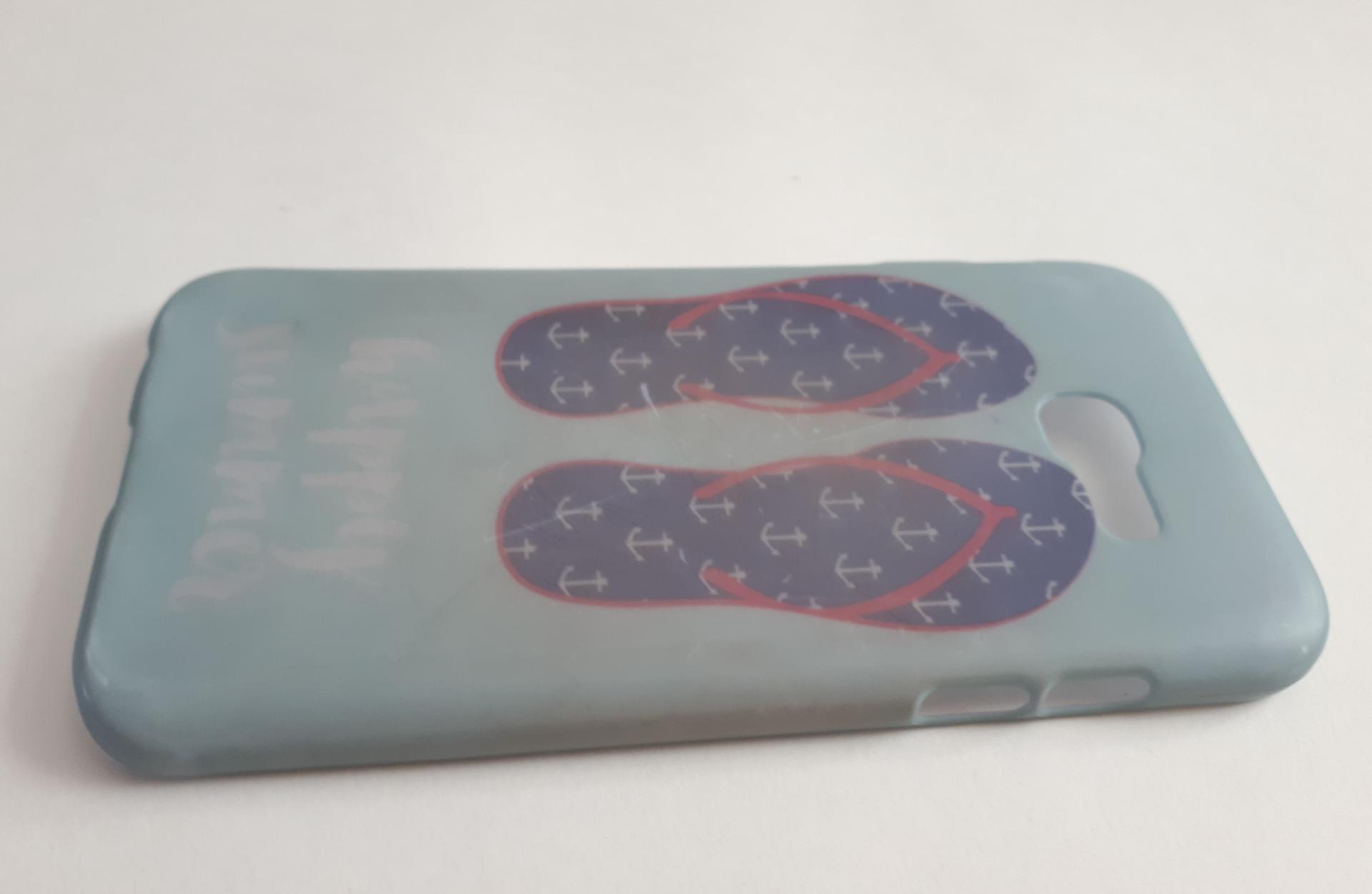

PC coated cover (caseblank product) sublimated with white korean film on machine ST2030 140 degrees 420seconds. Specifications says, that cover and coating is - scratch resistance, UV protected and keep the same colors during usage. That means that you can use it in retail bussines as cosumer product, without fear to get alot of warranty returns.
But in my case is alittle bit differnt - after 2-3 month regular use case is with white scraches, and colors are a little bit fade.
Question: Do i using bad sublimation process or cover and coating is bad? is anybody else has the same problem?

(I fhave attached picture, how case looks)
After two month regular use matt case looks like this (little scratches in corners and middle of case).
Is it regular?
Or is it disadvatge of matt case (glossy dont have such problem atleast not in such short period)?
Is it regular?

I think the scratches has something to do with the case itself, not the ink or press. I never experienced any such problem with matte cases, I just took one I have and tried to make scratches to it as hard as I could, to no avail (Sunfly PolySkin).
