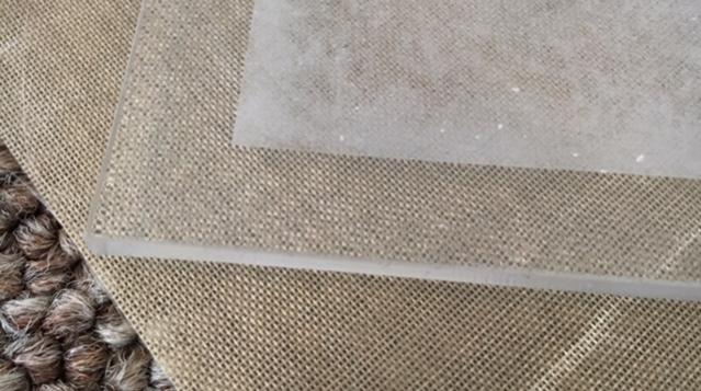

I want to print onto clear acrylic perspex sheets, I've seen a few youtube videos, so know it can be done.
What sort of time and temperature should I be using on my heat press? Also the thickness of the sheet is only 3mm, will this cause a problem?
Thank you for any advice given.

I just did it for 180 seconds using temp 180 and the sheet melted! Any ideas? :-)
spezzo
Posts: 19
Joined: 14 Jul 2016, 16:21
Re: Sublimation Printing onto Acrylic Sheets
Post by spezzo »
Ok sort of got it, but the sublimation paper is sticking, would this be too long under the heat press or the temp too high?
