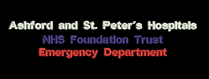

[FONT=&amp]I'be been asked to embroider some fleece jackets with embroidered text only on the left breast. The customer has requested 3 lines of text, the first line being:[/FONT]
[FONT=&amp]
[/FONT]
[FONT=&amp]Ashford and St. Peter's Hospitals[/FONT]
[FONT=&amp]
[/FONT]
[FONT=&amp]This is the longest of the 3 lines of text and if I choose to use Wilcom Block 2 font at 5mm height the embroidered line would be over 12cms long! This seems too long and might not work on the smaller jacket sizes.[/FONT]
[FONT=&amp]
[/FONT]
[FONT=&amp]How would you deal with this?[/FONT]
[FONT=&amp]Would you use a different font, if so which one?[/FONT]
[FONT=&amp]Any other advice?[/FONT]

I personally stick to a maximum of 10cm and if there is a situation where it is longer then I consider a few options. Please note that I do not do embroidery anymore so the suggestions might not be suitable.
Firstly, try using a different font, a condensed font perhaps
If not, then simply squeezing the horizontal might work as the reduction is not a huge amount
I presume both of the above might involve more than using built in fonts and may require a set up which will probably dig you in deeper financially. So other options are to either advise the client of the situation and recommend the name is done on two lines with a slightly larger space between the name and the blue text (my personal preference). Or go to the width of 12 cm and show the client the issue. You could do this by stitching on some felt and positioning on the garment and taking a picture.
As its only three garments it is a bit of a pain, however I have picked many clients by digging them out of a hole with a small job and to have them return with much bigger orders later.

Thanks for the reply.
I too try and stick to a maximum of 10cms, over 12 is just pushing it to much in my opinion.
I am experimenting with different fonts and maybe using a different font for the widest line.
Fortunately there will be far more than 3 garments :)
John

Hi John,
Ive Used Block 2Auto for the bottom one and Arial Rounded for the top. Both have the collumn width reduced by 10% or -10. Find that tool under the Pull compensation tab.
Height is 8mm. 11 and 10 cm long. I dont see a problem. Also narrow the understitch (zigzag) down so it doesnt show when stitching or use center line.
Hope this helps.
Edit. Also you can increase the density down to 32 and use the 60 thread if nessesary. This is useful if its really fine work but I wouldnt for this text as normal density is ok.

Go to four lines, centering the word 'Hospital' underneath the name. Or replace 'and with an ampersand.
Re: Left Breast Logo Problem - Any Advice Apprciated
pw66;120040 wrote:Go to four lines, centering the word 'Hospital' underneath the name. Or replace 'and with an ampersand.
I don't embroider but I'd go with the ampersand idea and think it might look better by reducing the size of the ampersand to about 70 to 80% of the main text.
When making text to fit in Photoshop, I either squeeze it horizontally or alter the kerning between the characters, or both.

I agree with the others here but as the customer requested only 3 lines of text they must be using some corperate logo. If you can the change it as it will look much better with four lines.
Im used to doing small text here as what youve written is often just one word in German.
It is also on Fleece which would be better with four lines as the embroidery will get covered by the fleece when the text is too small.

I have to agree with Earl. Going up to 4 lines, unless the customer specifically needs 3 lines, will allow you to increase the text size of the 'headline' name and keep within 10cm width.
Using an ampersand will still restrict you to small text, but is an option if you are limited to 3 lines.

i would not go to 4 as logo is 3, i would either do it at the 12, or change text slightly, and move the st. peters, by losing the gap between st. and peters= st.peters. still looks fine
