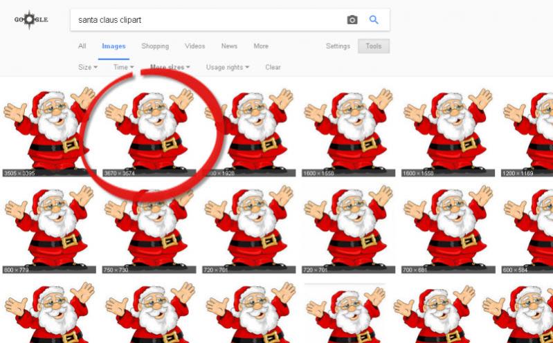

If you have an image at, say, 72 dpi, then changing the dpi of the image to 300 will dramatically increase the size of the image, but this is not the right way to do things as the final result will be a blurred or pixellated image. You need an image that has a NATIVE resolution of 300dpi or thereabouts (I wouldn't go less than 200dpi for most things).
So, if you are using images from the net then this usually means searching for, and downloading, very large images.
A tip when searching Google Images ...
When you find an image you like (and I'm not getting into a copyright discussion here!
), drag the images towards the top of the browser page ...
Drop the image into the Search box that appears when you near the top of the page ...
Another page will appear and if there are other sizes available you will be able to select the 'All sizes' link under the image ...
Now you will find all the available sizes of that image and you need to look for one that is large enough for your purposes. It may be that none of them are, in which case you are wasting your time looking on Google Images for larger versions of that image. It may also be that some of them are watermarked and you can always visit the site and pay for the image. Lastly, it may be that the larger image is simply a smaller one enlarged, in which case the quality will be poor, so make sure you view the image full-size before bothering to download it ...
