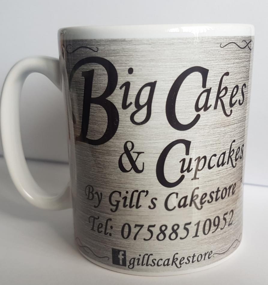

Re: Freesub ST-210 double mug press advice needed please
Posted: 21 Sep 2018, 16:34
by Mach-One
vB_ID:5404
vB_ID:5404
First print with new carts and printer 170c 170c
This is my fourth actual mug print since starting
