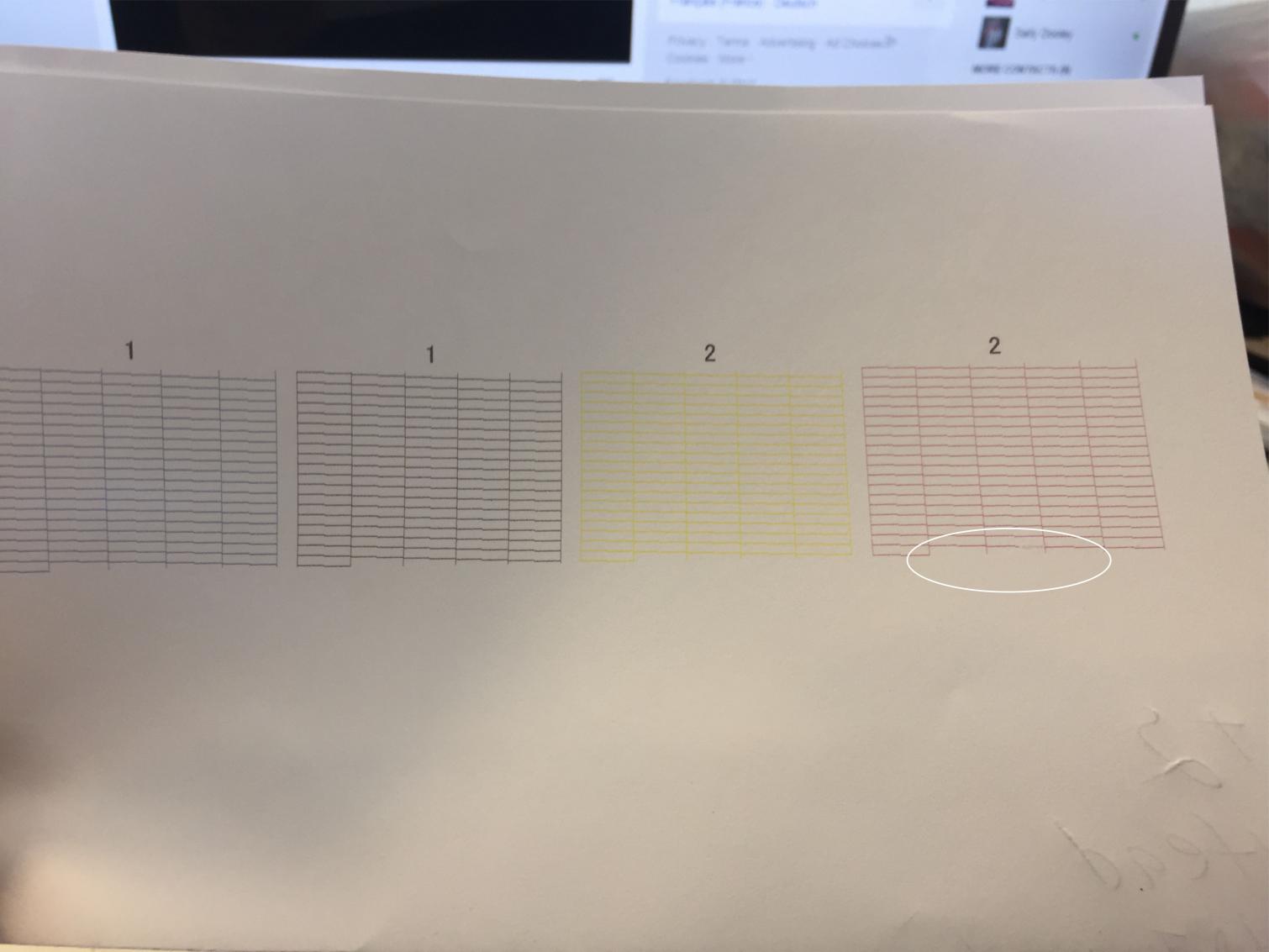

[FONT=&quot]Is there any need for alarm with my nozzle check looking like this? It appears to be printing fine after aligning, and a head reposition (and head cleanings)? Thanks for any advise.

Don't worry it will probably clear itself with use.
Re: Nozzle check Aisle 4
In my experience that's nothing to worry about. Sublimation tends to blend in small defects like this. Even with more pronounced banding on printouts I have still managed to get good, solid prints after sublimating.
Funny how the magenta head seems to cause the most problems on Ricohs.
