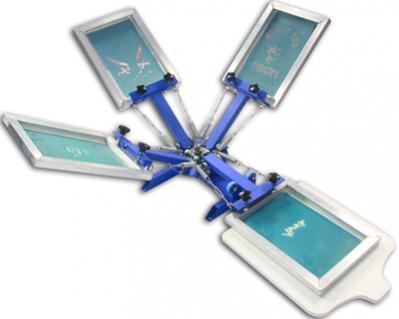

[ATTACH=CONFIG]1189[/ATTACH] Here it is

GoldRapt
Posts: 1025
Joined: 01 Nov 2009, 04:00
Been thanked: 8 times
Re: screen printing, what's best? plasticol or waterbased?
Post by GoldRapt »
Looks good, didn't it come with a table?
regards
Tony
-launching july/august 2026
COMA
Posts: 29
Joined: 16 Sep 2012, 18:19
Post by COMA »
nope. but you can set it on any table with 4 plugs
