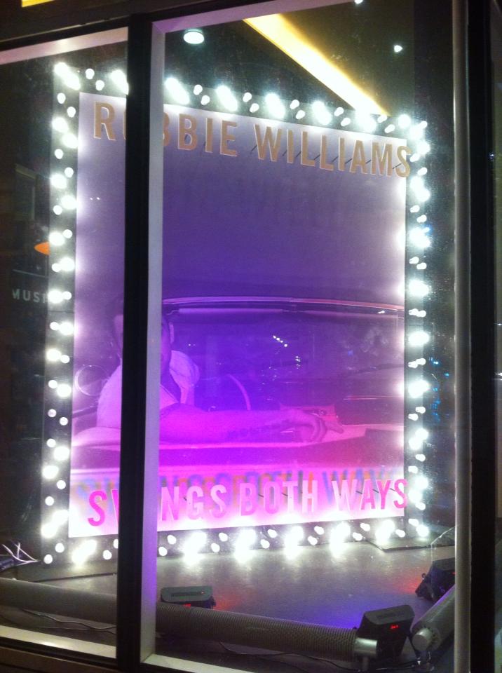

Hi All
Some people have been asking what its like working with wall paper. Well I did the attached install the weekend before last and decided I would use wall paper instead of the traditional vinyl. Although it is A LOT more expensive than traditional vinyl (by 400%) it made the job quicker and easier and it is my new favourite substrate to print on. What you are viewing is 3 meters wide and was built from scratch. The wall paper is 600mm wide and required 5 strips. The sticking of the wall paper took about half an hour max (which is a good thing as there was a problem with the lighting which meant that the graphics were not started till 11pm Sunday night!). Quite proud of this one as I handled everything and apparently even Robbie was impressed. Sorry for the bad picture, its all you get from an iphone at 2AM.
