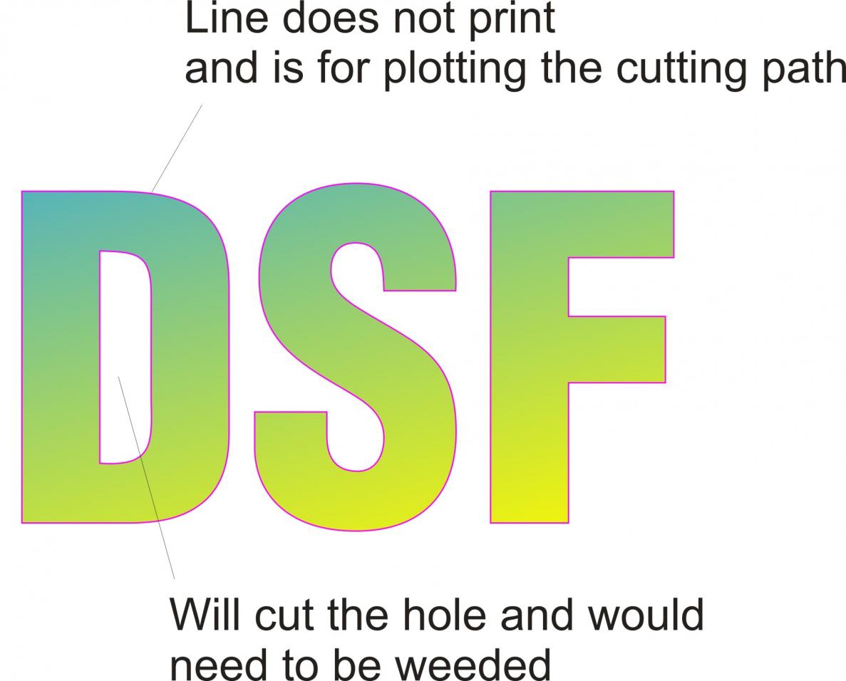

Files need to be supplied as CDR or EPS format with the cut line as a seperate line in an obvious single colour (100% magenta for example). I have attached an image to give you an idea.
You will need transfer film (something like the Evolution stuff from Grafitype) to enable you to transfer the printed item to your garment. I will test the cut to make sure that you can weed it easily, but I will not weed the entire job for the above price, was it you who had to weed 5000+ pieces recently
