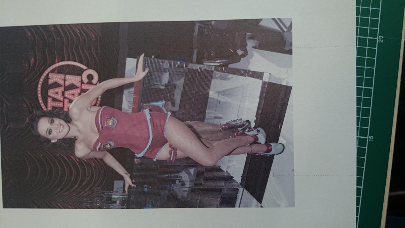

So I'm waiting for the guys at Nova-Chrome to give me a call back but thought I'd see if anyone here has encountered this and, if so, how they solved it.
On every print I am getting a set of dotted lines all the way across the paper which seem to be wheel marks of some description.
1st Call to NovaChrome advised me to run a load of paper through it while printing a very feint image (2% black fill).
It appeared to work as the dotted lines dissapeared - But as soon as I printed a normal image again they return.
You can see them in the image attached. I have a feeling I'm going to have to try and take it apart but would rather avoid this.
Any advice suggestions gratefully taken on board. Or If you've taken one of these apart before I'd appreciate any pointers.
Thanks Guys,
John.
Thanks Guys,
John.

Thanks for all your comments guys but I had this with decent paper also.
BUT - I have now fixed it. - Just in case anyone else suffers this...
If you shine a light at the 4 rollers on the out-feed and concentrate on the middle 2 – there are 4 wheels.
Just behind those 4 are another 2 wheels.
I simply took a dry cotton bud and cleaned those 2 wheels at the back (you can just get a bud in there if you’re careful).
Hey Presto - Problem Solved
