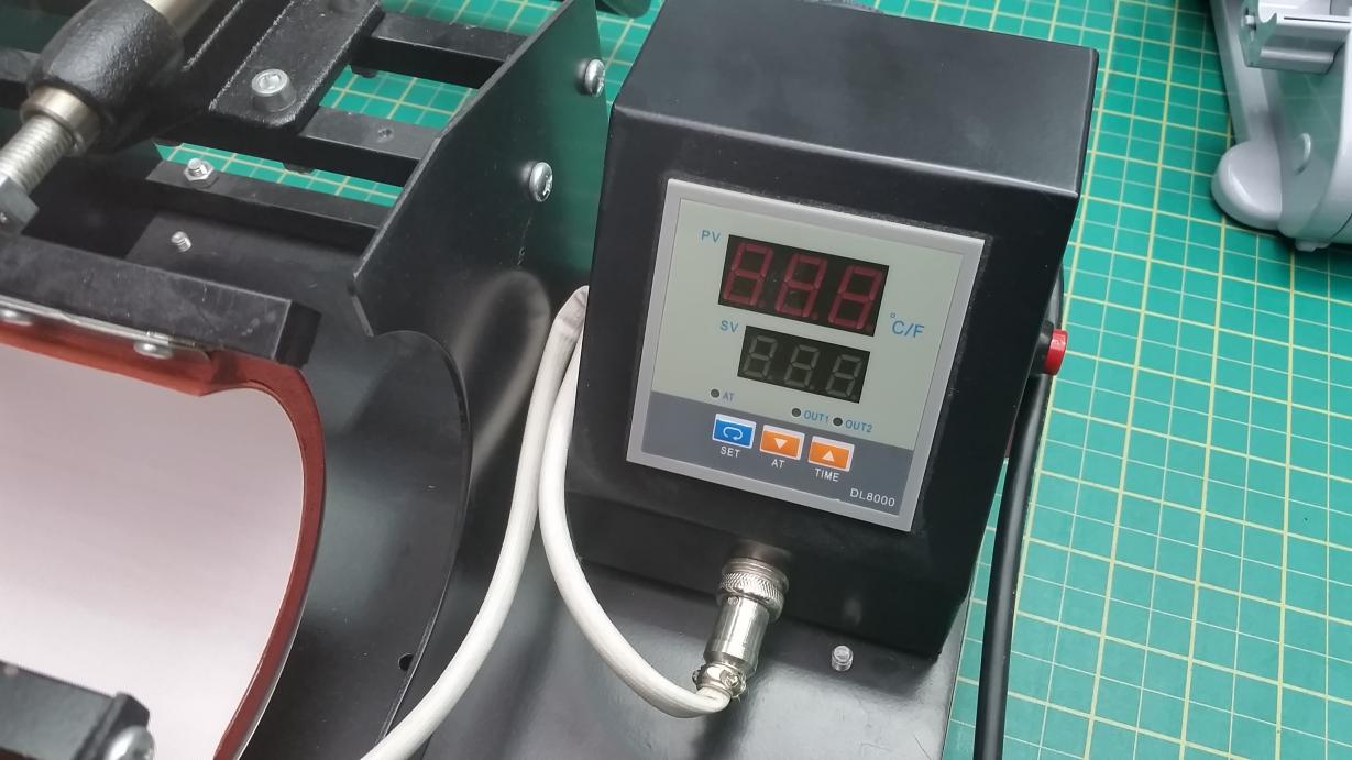

Good morning all
I am new to the forum, i have acquired a mug press with no setting up instructions. i was hoping someone with more knowledge than me may have a copy, how to set idle temp time etc.

Turn on and wait for display to settle
press set display should read SH (this is temp) use arrows to set temperature (approx 180)
press set display should read ST (this is timer time) use arrows to set time (approx 180)
press set to stop programming
unit heats and then idles to that set in step 1
when u press mug, push red button on side to make time count down
press again to stop it beeping when ready

Thanks, i was under the impression this had an idle temp which you would set at around 110. if you hold down the set button you have all different settings you can adjust. i thought once mug was placed into holder and clamped and you pressed the side button timer would not start until reached temp of 180

Not sure on that one, just found a generic instruction sheet for a 3 button press
Maybe list the settings options and people will be able to help with abbreviations

No joy on you tube, although these are the options
AR
P
R
CR
LC
RT
maybe some might know

does it have any stickers/branding/markings?
Alexis Hemsley
Posts: 4
Joined: 06 Feb 2016, 07:40
Re: Mug Press help
Post by Alexis Hemsley »
Not manufactures marking only DL800 & XY-003
